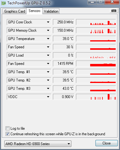

How are you checking that you have high load on idle?
Posts: 22032
PostPosted: Mon, 4th Apr 2011 00:04    Post subject:
this gadget
and gpu-z
PostPosted: Mon, 4th Apr 2011 00:58    Post subject:
why dont u open ccc and check load there ? huh huh.

PostPosted: Mon, 4th Apr 2011 01:10    Post subject:
Posts: 23584
