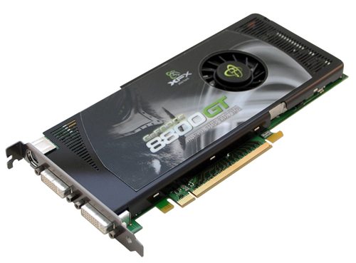

PostPosted: Sun, 18th Nov 2007 13:54    Post subject:
yeah. it does get hotter and is a bit louder than the cards with dual slot coolers though.
the G92 GPU is built with the 65nm fabrication process, while the older G8x GPUs use 90nm, so it runs cooler and uses less power at the same speed so they can get away with using only a single slot cooler.
here's a pic, looks nice.
